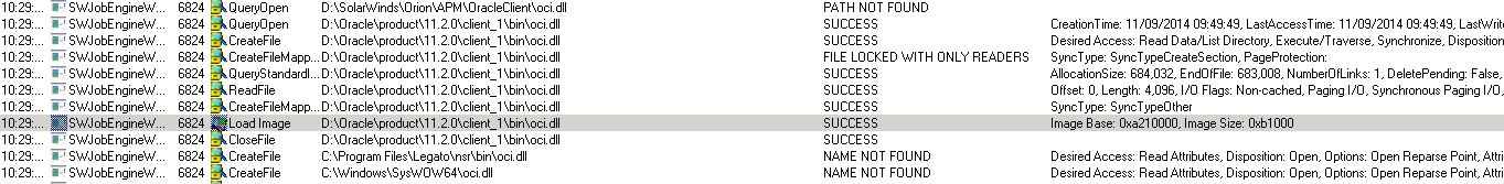

So i followed the troubleshooting steps outline here http://www.solarwinds.com/documentation/apm/docs/Configuring_and_Integrating_Oracle.pdf , to determine if solar winds was loading the driver.
The process monitor shows the oracle driver being found by the sw job engine process process and apparently being loaded.
So i restarted everything tried the monitor still got the same error.
Also checked the SolarWinds.APM.Probes. process using process explorer and the oci.dll does not seem to be in the list of dlls for that process, which i'm assuming means the oracle driver was not actually loaded?
Running out of ideas how to fix this, any ideas what else i need to look at to get this to work?
The oracle driver is the 64 bit version.
