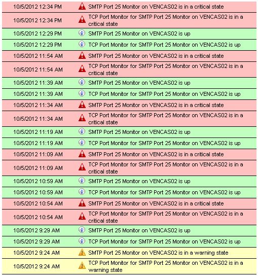

We seem to be having an issue with our CAS servers, as noted by the TCP Port 25 monitor template. We have it configured as follows:
The two servers we seem to be having an issue with is across the pond in The Netherlands. Our Orion server is in Canada.
At times, we are seeing very high response times (in the 3000ms range). It fluctuates, and then back down to normal. This will occur for awhile on one server, and then it will happen on the other CAS server. When reviewing the health of the server, CPU/Memory consumption is normal for a CAS server. The queues aren't getting flooded. I have PerfMon counters watching SMTP receive counters (however, I don't have SMTP send counters configured) and not seeing one CAS server receiving more than the other.
Can someone explain why I may be seeing this? Or, better yet, how this monitor actually works and what it's really measuring?
