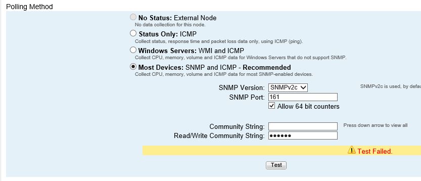

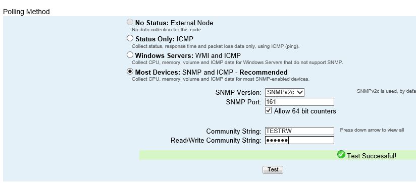

When I test the RW community in the "Edit Node > Polling Method" page it tests successfully for the RW community in the Community String field
but fails when I test against the Read\Write Community String

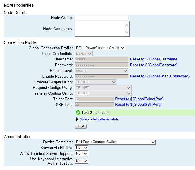

I have created a Connection Profile where I have entered the admin and enable password for NCM to connect to the switch and tested that it works:
