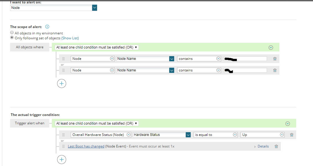

All I did to this alert is change the top part to Node and vendor = Cisco I'm not sure why you have two or statements at the beginning
Im wondering the same
The following set of Objects
All child conditions must be satisfied (AND) <--- change to (OR)
This will alert you for one of the hardware sensors either being disabled - equal to warning or equal to critical is that what you was looking for?
Is it a particular hardware health sensor ? ie fan etc ? or the overall status ? You can do this also
