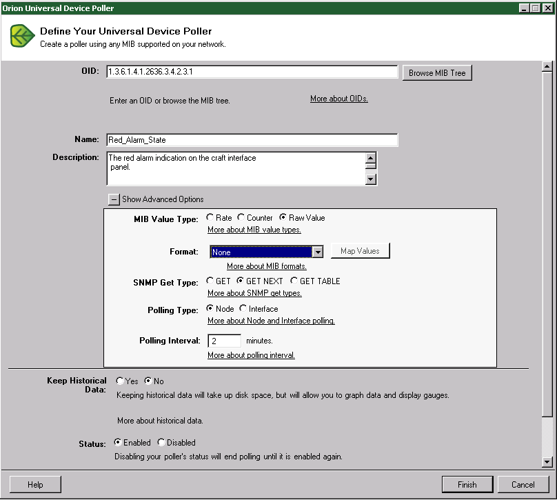

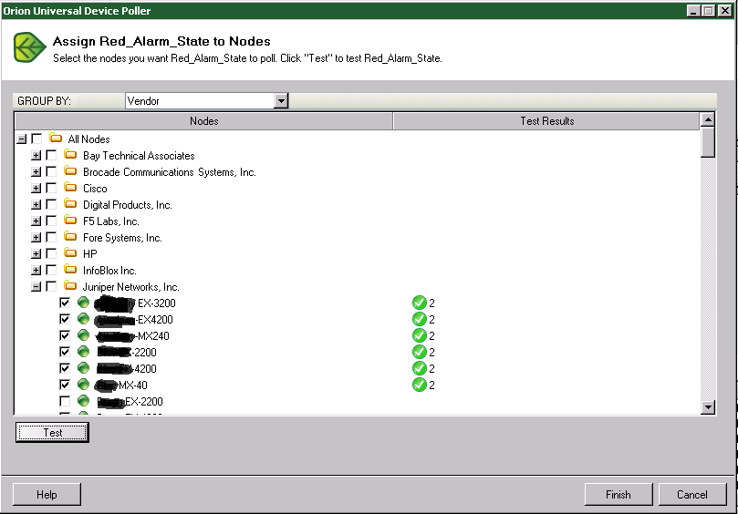

I have set up a very simple device poller to monitor red alarms on Juniper equipment. I would like to generate an alert whenever this UPD indicates a new alarm. The UDP works well, it will show the status; 2 for no alarms and 3 for alarm set.

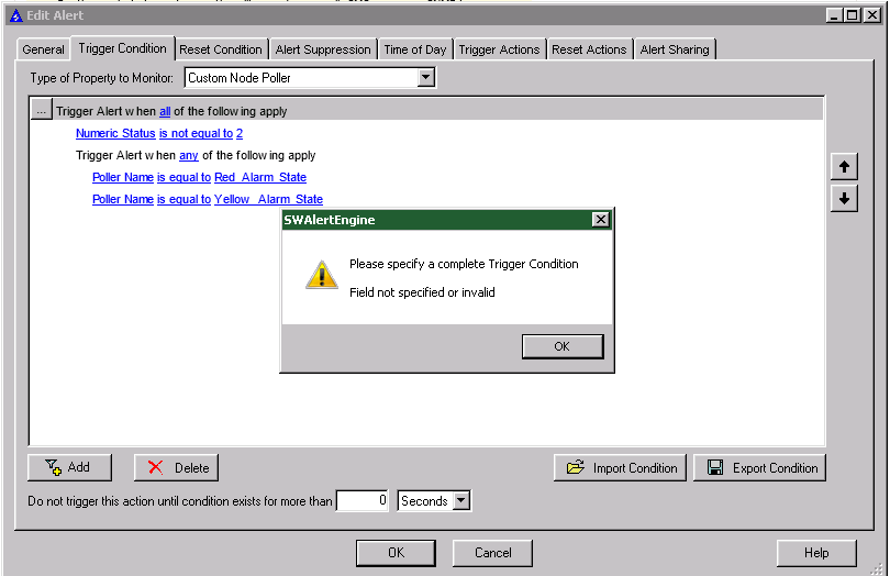

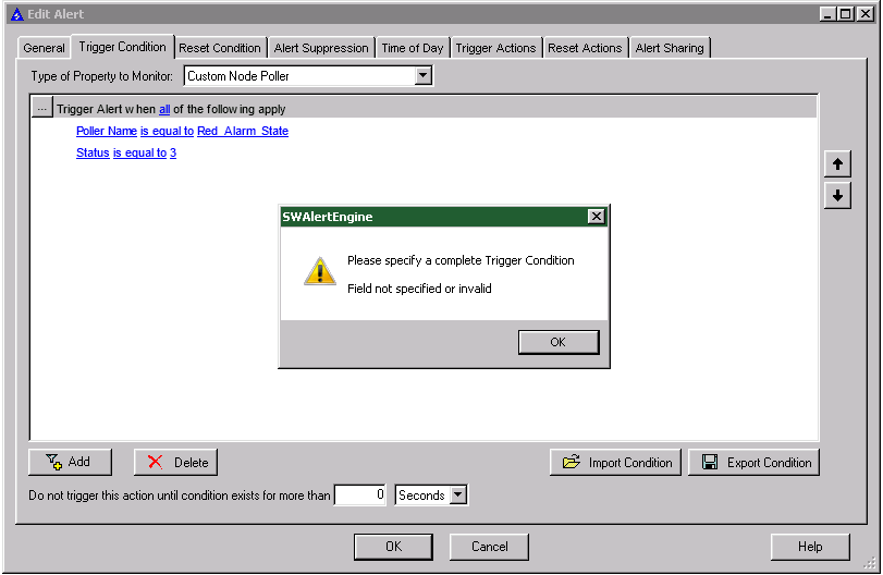

So I think the poller is ok. I want to set up a simple alert and this is what I get:

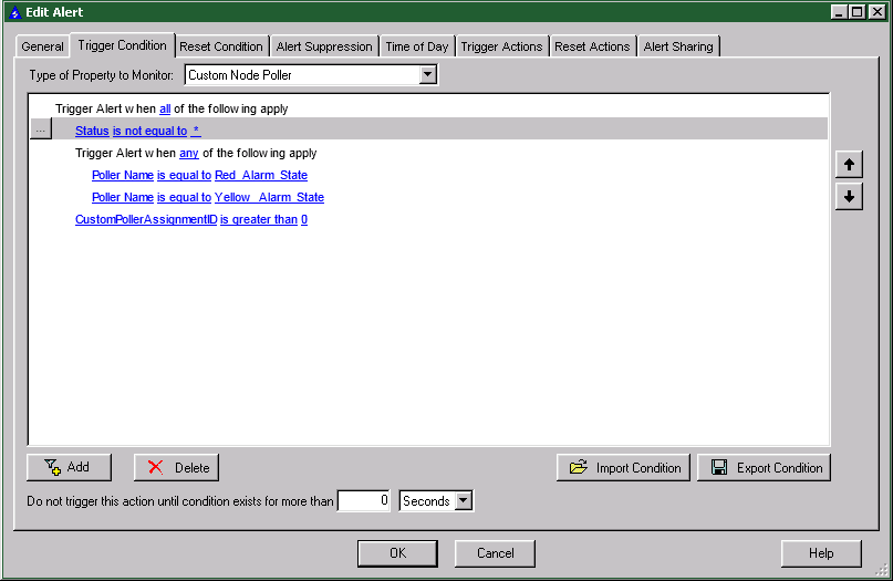

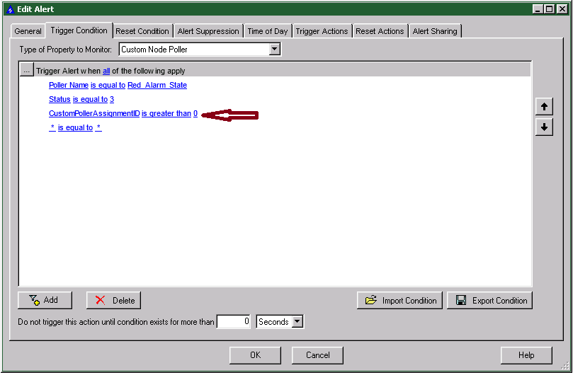

I have tried changing from status to Numeric Status with no change. The really odd thing is after I get this error I get a odd condition showing up. I clicked ok on the error message and added a simple condition. The result was this:
The simple condition showed up but so did the CustomPollerAssignmentID. I don't know where this is coming from, I can delete it but if I make any changes it comes back. Is there any reason the simple alert of Poller Name and Status wouldn't work? Am I just missing something? I tried this on two seperate installations (networks) and I get the same results. I am running NPM 10.7, NCM 7.2.2, SAM 6.1.0 and NTA 4.0.1. Any ideas?
