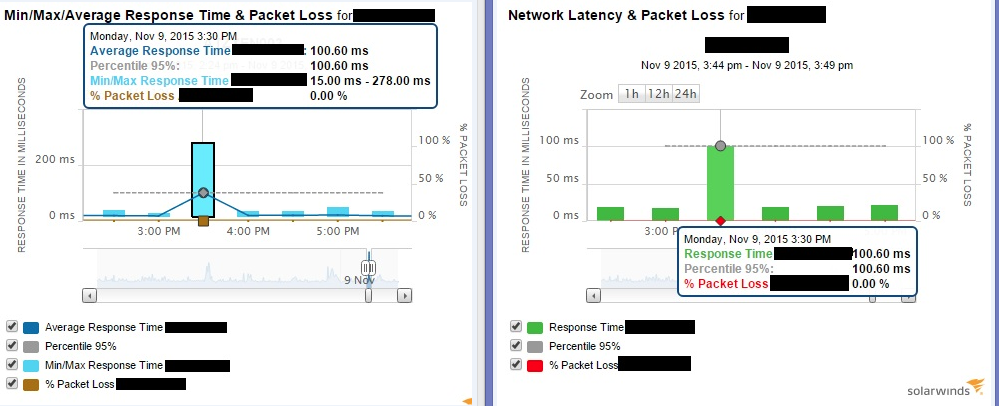

I’m new to using solarwinds and was wondering if I could get some advice. Currently at the company I work for users are complaining about issues using software on a server. I need to be sure that the issue isn’t the network or the server. At the times the users report slowness issues with the software solarwinds report that the CPU and mem are nowhere near taxed. I do however see an issue with Network latency. See graph below.
My question is really about how to read this report. Nornal pings from server to client is around 40 to 13ms. This report is specific to the node so I assume that the latency reported here is for packets coming into the server? Is there a way I can see ALL traffic coming into the server to figure out what is causing this latency or where the latency is coming from? Does this signify a bottleneck in the network due to a high volume of data being moved at this time? If so how can I confirm using solarwinds reports?
