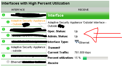

Here's what I have done for a NOC TV in my office. Repurposed an older Sharpe 50" TV (wall mount):
I have SolarWinds, our security intelligence platform and SD-WAN dashboards rotating on the TV.
