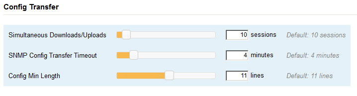

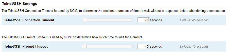

Current Solarwinds NCM Protocol Settings

The E-Mail Reports back "ERROR: Cannot download Running config : Connection Refused... " on the HP Switches. Each job ran is inconsistent with successful and failed devices. If I manually grab the running and startup configs via NCM, that too is hit and miss on getting this error. It works "most of the time"; How come not all the time?
So basically, going to SSH as the protocol to get config backups through Solarwinds is a failure. Above is just examples of multiple combinations I've used to try and get SSH to work consistently to get config backups. I've changed the Solarwinds NCM settings and still the same inconsistent results. I'm going to open a Solarwinds ticket as well, but I'd thought I'd ask the TWACK community as well.
