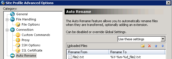

I have my Scheduler Profile set up as follows:
Note:
- scheduler profiles don't have the ability to specify a Local folder... so I have to specify the full path in the Scheduled Job Actions.
- Only one rename is specified since I'm not renaming file1

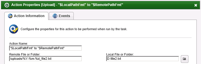

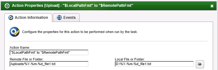

And my Scheduled Job Actions (with full path for local files) are:
The logs of the job show thi
[13] Mon 16Jun14 10:41:09 - (Action: "D:\%Y-%m-%d_file1.txt" to "/uploads/%Y-%m-%d_file1.txt") - Uploading from "D:\2014-06-16_file1.txt" to "/uploads/2014-06-16_file1.txt"

[13] Mon 16Jun14 10:41:11 - (Action: "D:\%Y-%m-%d_file1.txt" to "/uploads/%Y-%m-%d_file1.txt") - Action successfully completed.

[13] Mon 16Jun14 10:41:11 - (Action: "D:\file2.txt" to "/uploads/%Y-%m-%d_file2.txt") - Uploading from "D:\file2.txt" to "/uploads/2014-06-16_file2.txt"

[13] Mon 16Jun14 10:41:12 - (Action: "D:\file2.txt" to "/uploads/%Y-%m-%d_file2.txt") - Action successfully completed.

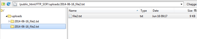

In both cases, Voyager thinks the destination filename is a folder... and of course those folders don't exist. For some reason, Voyager creates those folders and then deposits the files in them. In the case of File2, the date does not even get appended to the filename.
Can anyone explain to me where I've gone wrong? Thanks.
