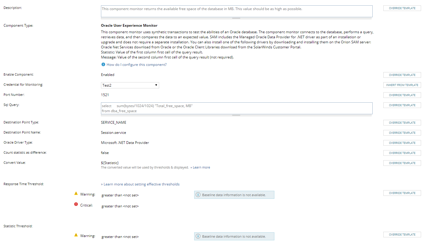

I am having a few issues with trying to authenticating and monitoring some instances of Oracle.
We run quite a large oracle environment, where the servers (windows 2008/2012 servers) are in a cluster.
Example
Server-A01 and sever-A02, for those that are unsure. I am trying to monitor the services on the Oracle boxes and getting the following error below.

Also you may try to use another 'Destination Point Type' monitor configuration option, for example choose 'SID' instead of 'SERVICE_NAME'.
I read the document that was accompanied with the error message and think it's something to do with the Oracle side and not the solarwinds side, but I am unsure. I kinda got it, but was a bit unsure with the familiar terms. Some stuff I do know hasn't happened, name or domain change has not happened, the only think that has happened is that two years ago we changed to a new solarwinds environment.
I change it to SID and get the following error.
