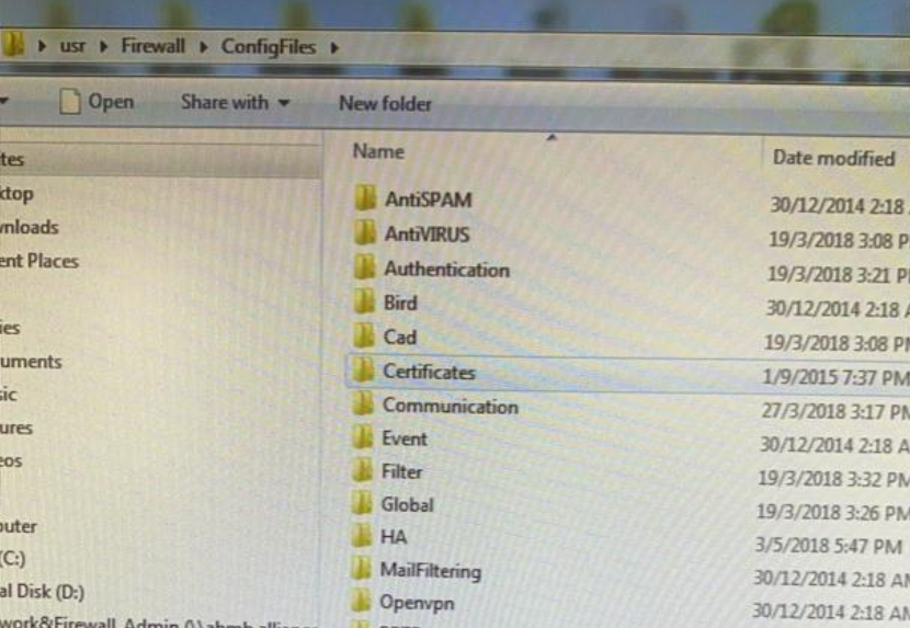

- The output will be readable file with multiple folder
i have configure the NCM template to perform the backup and SCP out the file to orion server and when click downloading the configuration i can see the config.na file is already in SCP orion server but still return fail on NCM dashboard. but still im stuck as the file is not readable and i cant view any changes on the firewall as the backup file is not readable.
