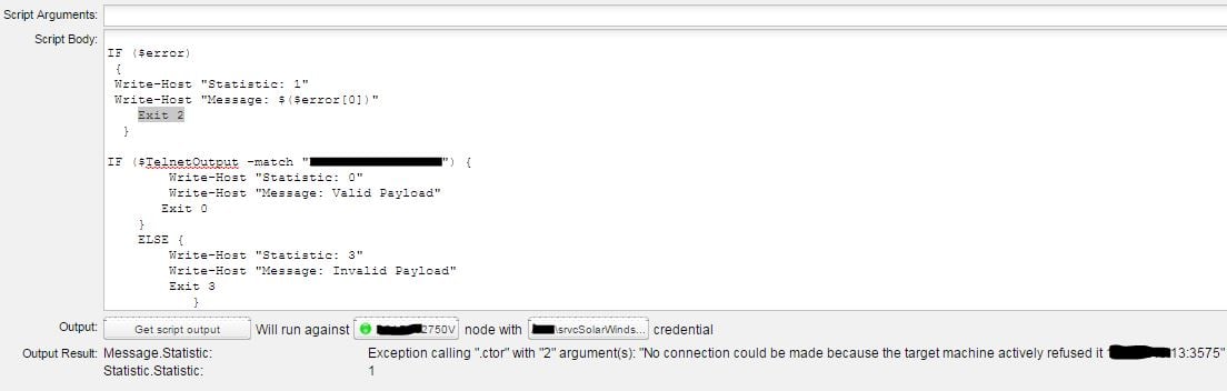

I having a tough time getting my script to correctly report the exit code to SAM 6.1.1. I have read The Basics of PowerShell (part 3) and I am using the required Message, Statistic and Exit codes. My script Telnets to a server (using a built telnet function, grabs a payload and verifies that its valid. I want 3 exit codes, 0 - Payload is confirmed (Up), 3 - Payload is invalid (Critical), 1 - Any error & failed to connect (Down). Exit codes 0 and 3 report correctly but 1 will not.

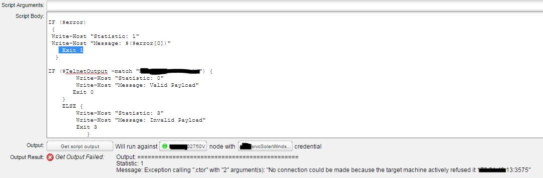

IF ($error)
Write-Host "Statistic: 1"
Write-Host "Message: $($error[0])"
Exit 1

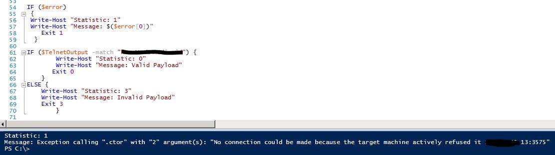

Tests for Exit 0 and 3 are successful with proper output. Test for exit 1 is done by turning off the application. The port is closed and the telnet connection will fail. Below is the error that I get for Exit 1 "Get Output Failed". It should result in Exit 1 - Component is Down.

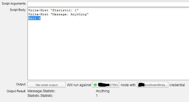

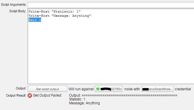

I found that if I changed "Exit 1" any other number value it will run successfully. Something is wrong with Exit 1.
