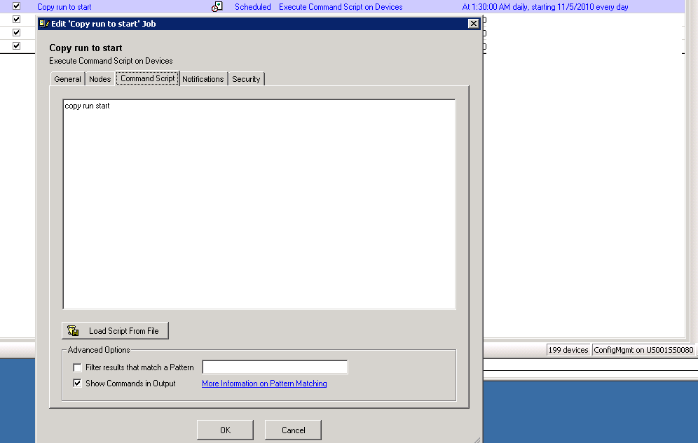

I have NCM job running to "Execute Command Script on Devices" for my cisco devices every night, the cmd is "copy run start".
The job log shows that Solarwinds was successful in running the script for my cisco device, Nexus 7010, IOS 5.2.9.
On my Nexus 7010 switch logs it shows that the script failed to save my switch config, this happens every night.
"2014 Jan 16 01:32:56 %SYSMGR-2-CFGWRITE_USER_ABORT: Configuration copy aborted by the user.
2014 Jan 16 01:32:56 %SYSMGR-3-CFGWRITE_FAILED: Configuration copy failed (error-id 0x401E0000)."
It takes 1 minute to save the config on the Nexus 7010.
Is there a way for me to set Solarwinds to wait longer, like 90 sec, before exiting the script?
