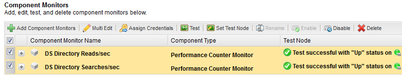

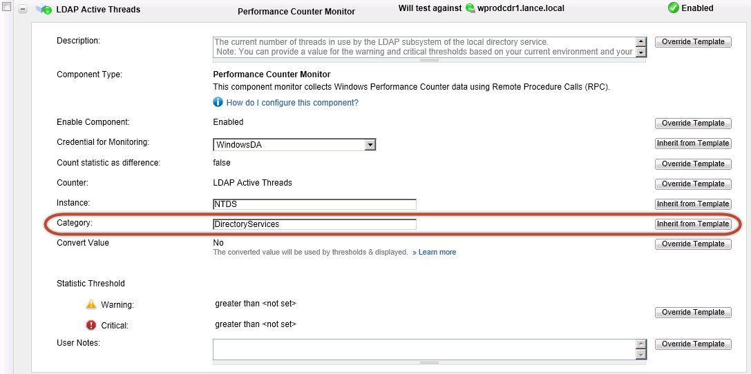

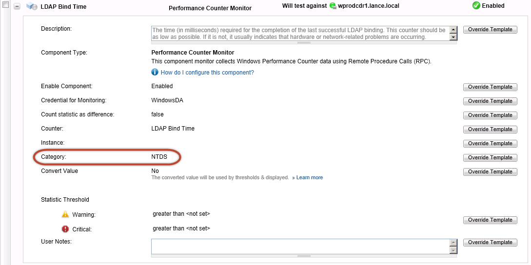

We are running 'Active Directory 2008 R2 Services and Counters' template on 10+ domain controllers and all report correctly except for one trouble server. The service monitors work correctly but the performance counter monitors are failing with the error: "Bad input parameter. HResult: The specified object is not found on the system."
I've searched around and tried the following fixes:

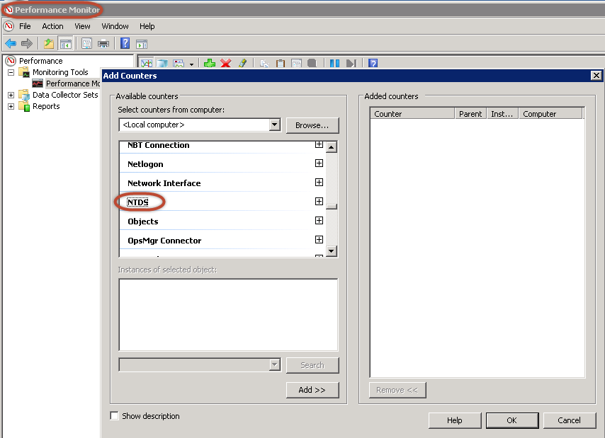

- Tried to rebuild the performance counters

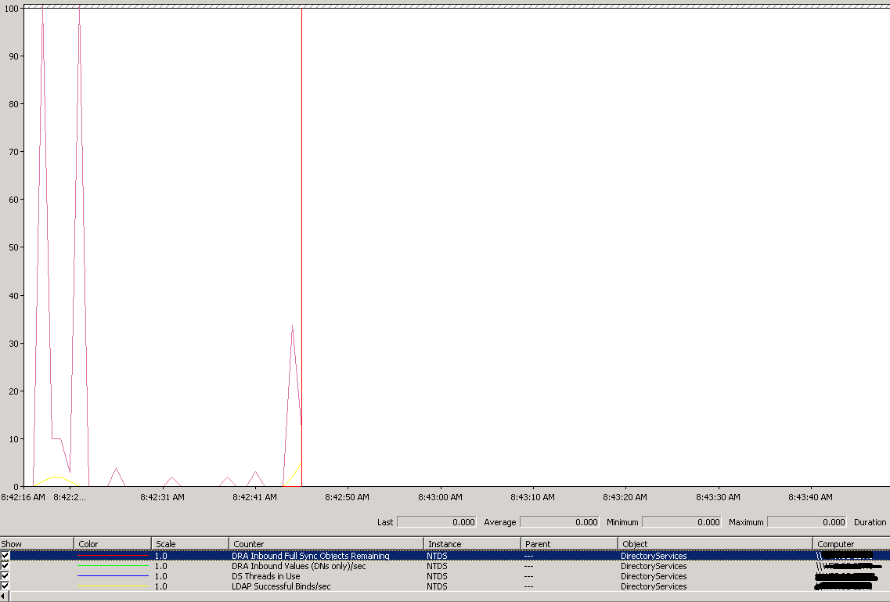

- Ran Perfmon from the Solarwinds Server, managed the not working server and selected several counters from above that are not working via the web browser and they monitored correctly
- I thought it might be a permissions issue but I ran PerfMon from a working DC and managed the not woring DC and it reported correctly. I tried this in reverse and it also worked correctly.
