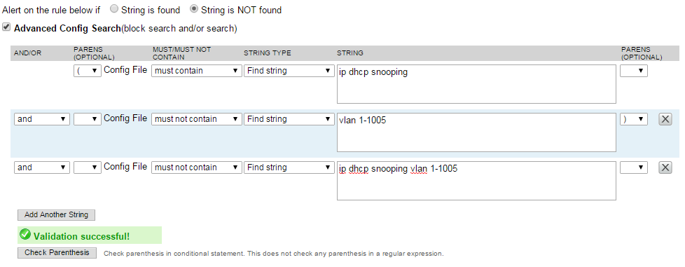

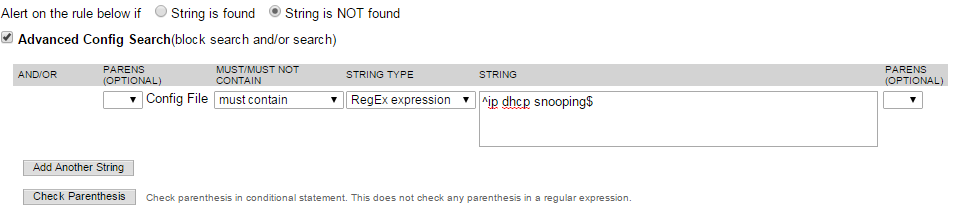

If I setup NCM to look for just "ip dhcp snooping" it will falsely match on switches where it is also enabled on a per-vlan basis. I have tried editing the rule to use a regex that matches the whole line like so:
I also tried string dependency with parenthesis but that also fails:
Does anyone have a way to force NCM to match a single line in its entirety and if that line is not found, alert for the profile?
