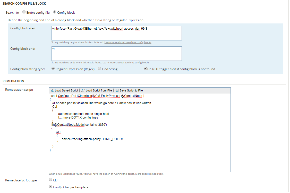

I have the script to determine the model figured out (I think), but it's using a Config Change Template. How do I use that config change template to change only the blocks (interfaces) found to match the violation parameters while still adding in that extra line for the 3850s?
Below is a dummied down version of the script I'm trying to run and a picture of how I'm trying to apply it. If ran, it would just do those commands under CLI in the global once and not for the multiple interfaces in violation.
script ConfigureDot1XInterface(NCM.EntityPhysical @ContextNode )
//For each port in violation line would go here if I knew the proper syntax
CLI
authentication host-mode single-host
!.... more DOT1X config lines
if(@ContextNode.Model contains '3850')
CLI
device-tracking attach-policy SOME_POLICY
