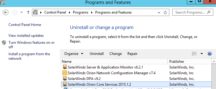

We're starting with 3 UCS chassis, and two fabric interconnects. Solarwinds NPM is running version 11.5.2.

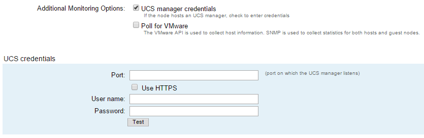

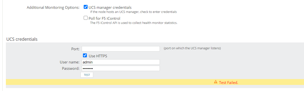

Answer (Maybe): 3. I decided to add each FI as a node without UCSM polling, and then I added the Mgmt VIP with UCSM polling. I configured each FI to poll all interfaces, and I configured the Mgmt node to only poll non-interface elements. The idea here was for the Mgmt node to focus on UCS polling and let the FI nodes handle interface issues. Polling some of the stuff at the top of the list might be redundant, but I wasn't sure if any of it was necessary for UCS blade info.
I'd recommend a service account for the UCS Manager Credentials section, and it will obviously need at least read access to UCSM. When entering domain credentials, you have to specify the domain, but in the format that the domain is linked in UCSM (refer to the LDAP config in UCSM), AND with "ucs-" in front of it.
So for example, if your active directory domain is mydomain.corporate.realm, and you've added this into UCSM and called it just "ADmydomain", the credential has to be entered as "ucs-ADmydomain\mysvcaccount".
Fun fact, I had issues with the service account at first, so I added the Mgmt node without UCS polling initially, and then added the UCS polling once I resolved the service account problem. (Ended up having to launch UCSM as the service account one time to register the account in UCSM.) Doing this, the Mgmt node never successfully displayed UCS blade info. I deleted the Mgmt node, then re-added it and included the UCS polling as part of the initial node creation. Worked fine that time.

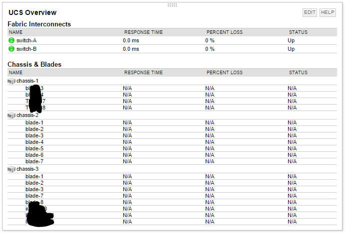

4. Once both FIs are added, you should be able to view the node that UCSM is active on and see the UCS Overview page element (ours showed up in the Network tab by default).
Second Issue: UCS Overview displays the status of each FI, and the names of the enclosures and blades, but the status of the blades doesn't populate.
