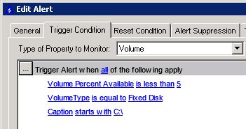

Is there a way to create an alert to monitor the drive space on just the "C:\" volume on servers?
This is the alert I would like to add the condition to..........
The following alert trigger condition would alert you if any of the "C:\" drives in your environment had less than 5% space available.

aLTeReGo has already answered your question (you would find it at the top of the discussion) , just remove the last line from trigger condition , which is 'Caption starts with C:\' - that will work for you.

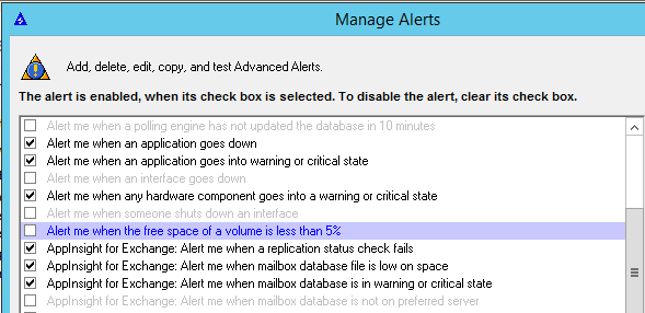

SAM comes with an out-of-the-box pre-configured alert that's applicable to all volumes by default entitled "Alert me when the free space of a volume is less than 5%". It's not enabled by default, but that's a simple matter of checking the box.
