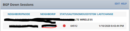

I'm trying to write a report that will show me failures like this

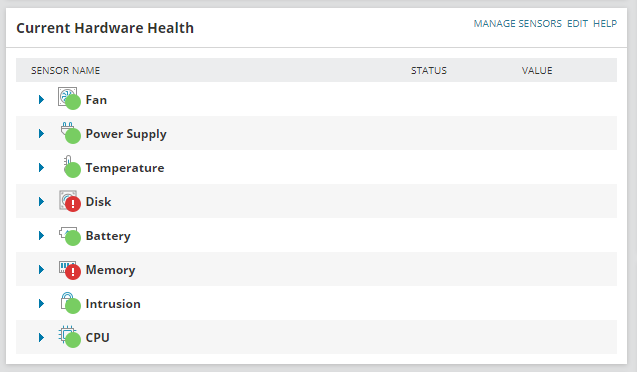

Or failures on drives like these.

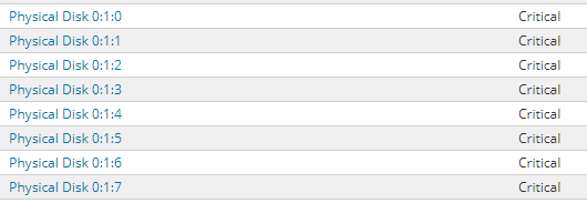

In the report I get entries like this

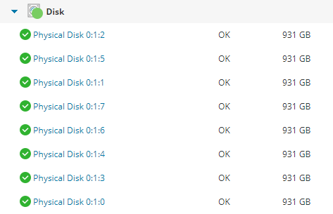

But when I go to the node and look there I see this
Why does the report say critical?

From here my guess would be that the status you are displaying is not the individual sensor status but instead is maybe the overall status for the node hardware. Sometimes it can be a pain to hunt down the status you want when the gui shows 8 different kinds of status objects.
That's correct. On the main node page I see this

But my second example above is polled by SNMP. Report shows all drives are critical by actual node status shows they're ok. Weird.
