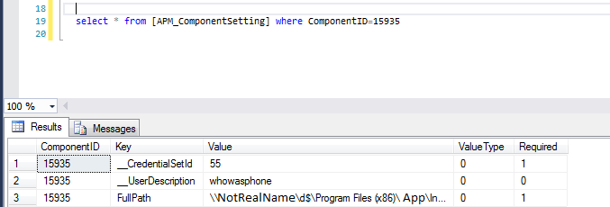

I get an error, "MACRO SQL ERROR - Error converting data type varchar to bigint." when I leave it at ComponentID = '${ComponentID}'}, but if I set ComponentID = 15935 it works. Please what am I doing wrong?

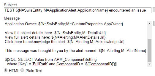

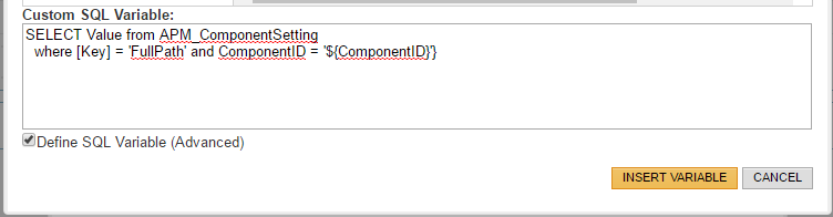

Above is a snip of values in the database below is the modified query I mentioned with 'FullPath' instead of 'Url' for the key
This is what it looks like when you insert it as a variable that gives me the error.
Like I said to make it work hard coding in the component ID to this specific one (15935 vs the variable "${ComponentID}") does return the file path, but it means it wouldn't work for anything else I tried to apply this to.
