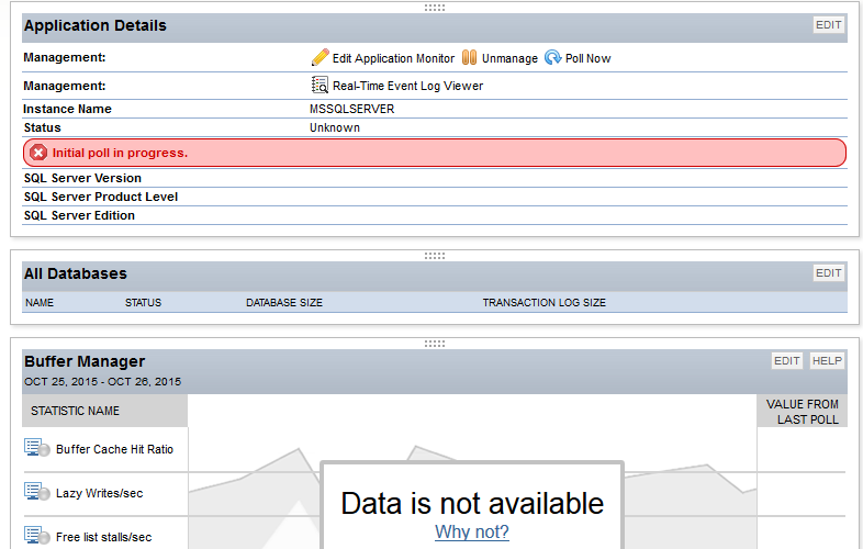

We have been using the App Insight for SQL templates to monitor our SQL databases for about 2 years and have had no issues (generally) getting it set up and collecting data. Our SQL databases are set up in many different ways ( versions, clustering, etc.) but just recently two of the templates stopped polling on two servers that are in a SQL 2012 sp2 "always on" cluster The other servers in that cluster are polling OK.
I have tried/verified:
1. The account we're using "works" and can connect (via putting it in the template and running the tester returns "ok"). The SQL team has validated it has the rights it needs. The monitoring account we use is the same for all databases in this cluster. It is using windows authentication
2. I have tried removing and re-adding the AppInsight for SQL template to the servers. No change
3. I have tried removing and re-adding the SQL server to Orion (then the template). No change.
In addition: The SQL DBA's have indicated they don't see Orion even attempting to connect to SQL.
I have seen in the docs how for windows 2012 clusters you're not supposed to add the AppInsight for SQL template directly to each node in the cluster (which we have always done) but instead to attach it to the "cluster IP address". We have a 2012 active/active cluster and the data polling appeared to be working just fine (until it just stopped

Also: I had the DBA's execute some of the troubleshooting steps I found to determine the cluster IP and the results are different that expected.
The SQL statement they ran:
SELECT SERVERPROPERTY('ServerName')
results in 2 server names (specifically, the two servers we are having issues with), not just one as the docs suggest it should.
