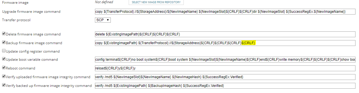

specifically what is occurring in my environment is that it runs the back up portion of the script to back the firmware up to my SCP server (which is Solarwinds) after it says success it just doesn't move on to the verify and the rest of the script i've restarted the task multiple times, I've let it sit over night, and still just sitting at the same spot.

Below are the strings for backup from my template
One thing to note that I modified was that on the backup portion i had to add the 4th ${CRLF} (highlighted) or the task would fail when the device prompts for a password. After I added that it was able to backup successfully.
