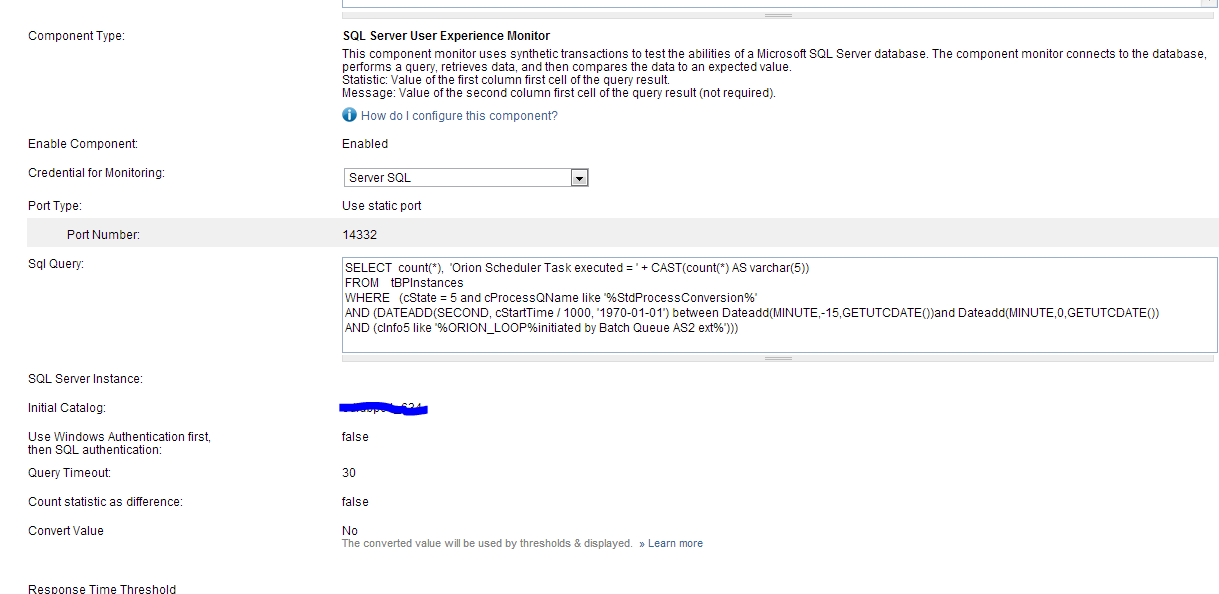

1.) I'm running a custom application monitor template using SQL Server User Experience Monitor Components, 14 total, each with a unique query, and consistently 3-4 specific components randomly go to 'Down', 'falsely' triggering alerts
Template I am using includes use of SQL Authentication first. Query is nothing special. logs in and tests fine.
The monitor credentials on target machine as used in SAM credential library are SQL Authenticating, have full sysadmin privs, target machine has unlimited connections enabled.

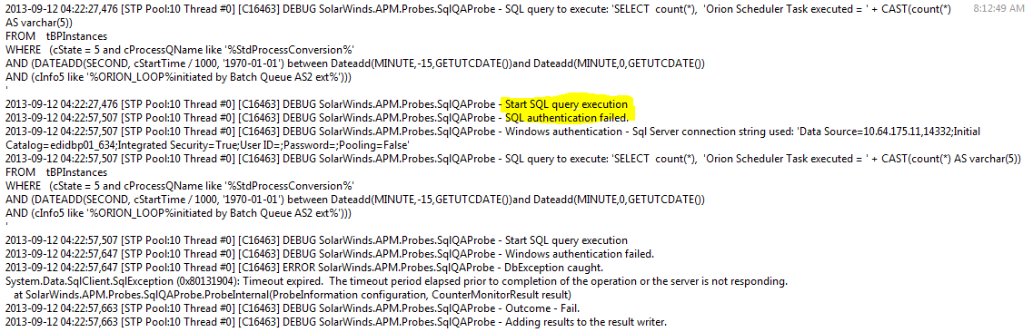

Running debug logging on the application monitor, and subsequently reviewing both the login errors as seen from the target instance, and the security log, it appears that when poll requests go out, these 3-4 queries are reporting login failures (others log in just fine), thus denying access and going down state. Its totally random.

From SAM 5.5 debug logging, shows SQL Authentication is tried first, fails, then tries Windows Authentication. What our admin means by 'others' I think is those attempts by SAM to use Window Auth, which doesn't parse anything, so it see's blank. But the first 'failure reason' for unknown username or bad password I think is associated with the first SQL Authentication attempts.
