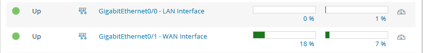

We would like to change the status of the balls in the tree. As soon as it has a problem the first ball becomes red.
At the moment we have the ball that turns red only when everything is down
