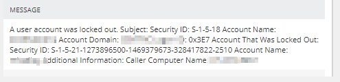

So I might be thinking about this completely wrong but I have been digging around THWACK and found some really good information and want to make sure what I want to do I can actually do,
1. I setup a custom SAM template and applied it to all of my DCs to monitor for Event ID 4740 when a user gets locked out.
2. I have a domain controller dashboard that I added a custom SWQL widget to so these event would show on the page.
3. With some help from THWACK I was able to get this widget configured correctly so the events show up in the widget.
4. I have been trying to set Enable Search on this box so if a user gets locked out we can figure out where they got locked out.
5. This is what it looks like now but when I hit search and put a name in it or domain controller it looks like it is searching but it really is not.
6. Is that the purpose of the Search SWQL Query box or am I completely off base on this?
