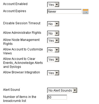

You'll need to work backwards and see when the user can unmanage a node. Even try creating a new account from scratch and see if it works for them. Maybe the user in question belongs to more than 1 group.
First disable the group(s) and then play around with the user's settings till you get it working. I tested a user with the below settings and I was able to unmanage a node. The account I was using was a Solarwinds account (rather than an AD account or group account).
