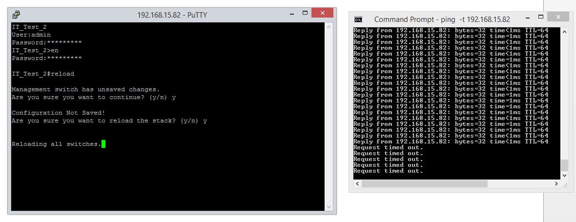

continuous pings to the device do not drop and the device uptime does not indicate that the device has rebooted

When I need to do this via telnet the following are my sequence:

The job is experiencing an error at the second "Y" prompt. I can't understand why, since it works in the telnet session.
