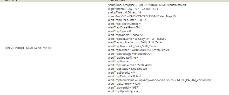

I am wondering if anybody could help me, we have SNMP traps coming in from our BMC scheduler and we want to get advanced alerting working in Solarwinds so we can have escalation etc. There are a few problems I'm coming up against that I'm not sure I am going to be able to achieve what I want.
1. There is no SNMP reset trap only the job failure.
2. I need to alert on pretty much every job (with a few exceptions).
The trap looks like the following:
