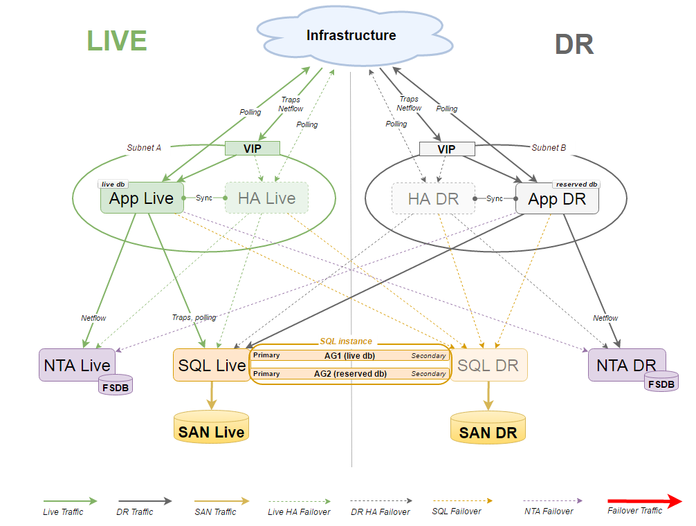

Deploy exact copy of your live environment at the DR site, use Disaster Recovery License and point it to "empty" database. By "empty" I mean that you do not need to populate it with any assets, just install fresh deployment and leave it as it. You don't even need to configure any settings, views, etc - just vanilla setup (cold standby so to speak)
Now, you will have an Active-Active setup (although not quite Active-Active as initially suggested by SolarWinds in the above PDF. I would rather call it Active-Reserved, because at the DR site you do not add any devices and you do not configure it)
DR considerations:

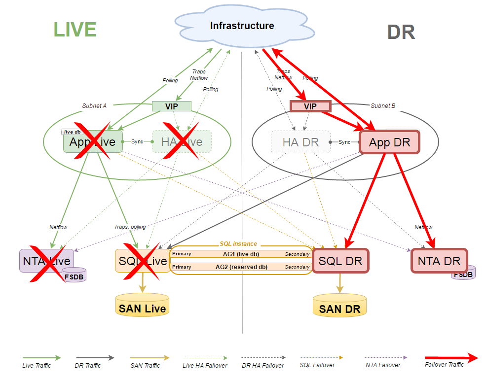

SolarWinds kit at the DR site will just sit there and do nothing until DR is invoked. We have Database AG in place (mirror formally). So, in the event of main site failure SQL will fail over to mirror copy at DR site. Because we already have SolarWinds deployed at DR - all what will be left to do is to run configuration wizard and re-point DR deployment from empty db to mirror copy of live db at the DR site. Recovery process should last as long as it takes for the configuration wizard to complete its magic (haven't measured it yet, but it will depend on number of module, hardware kit, etc. I anticipate under 2 hour). Well, not instant fail-over as with HA - but good enough, providing that monitoring by itself is not business critical tool and in the event of site fail-over monitoring definitely is not on the list of priorities for the business to worry about, unless you are managed monitoring solutions provider (which I hope you are not, as otherwise 2 hours recovery may be a "killer").
If you do not have SQL AG, then simply ensure you backup your SQL at live site and transfer your backup over to DR site on a regular bases. No need to recover, but fresh backup should be available in the event of DR to restore DB at the DR site
To "complicate" things further (or I would better say to safeguard and increase availability) - we also plan to create HA cluster for application layer (new feature) at both sites, therefore protecting from local app server failures. Although HA at DR might be a bit excessive - we would like to keep things as closely mirrored as possible between DR and LIVE sites
And, yet another thing - NTA server. You can have it on same APP box (which is not recommended, although fully supported), or you can have a separate box. In the event of DR you simply recover NTA DB from backup at DR site and then you should be able to switch to DR box as well

Diagrams:
Normal operation
Site failover:
