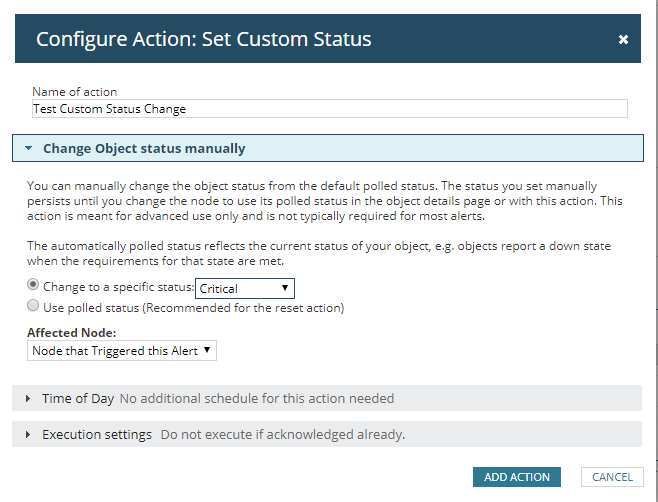

Hi ccandido so if you goto your Alert and go to the Trigger Actions tab - Then Add Action. You will see an option for "Set Custom Status"
From this screen, you can choose which Status you want the Node to be changed to. You can also select a specific node that gets changed, which you could use as a traffic light node to indicate an issue rather than updating the triggered Node, but that might be over-complicating things.
* Note - Make sure you have a Reset Action to change the status back to it's Polled Status once the alert is reset otherwise the Node will stay in that status.
Thanks David Smith. That is what I was looking for!
