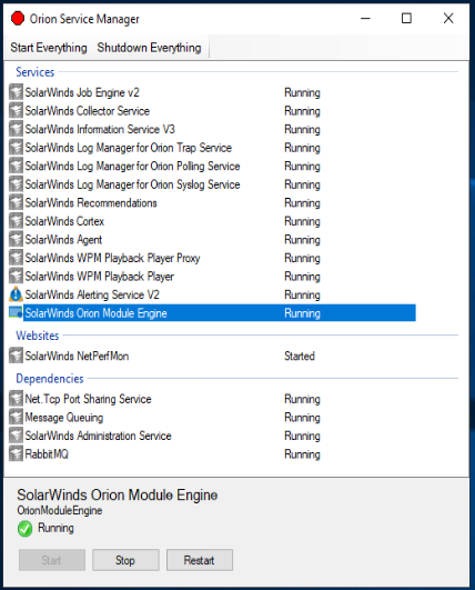

It looks like today's release fixed the issue, I think. I just installed it. I got a weird error message at end of config wizard that said error 'packages' weren't able to install, but didn't list what didn't install. All products are currently running in Orion Service Manager. When I get time to poke around, I will let you know if anything is being janky. Good luck!

Error starting Service NetFlow Service
