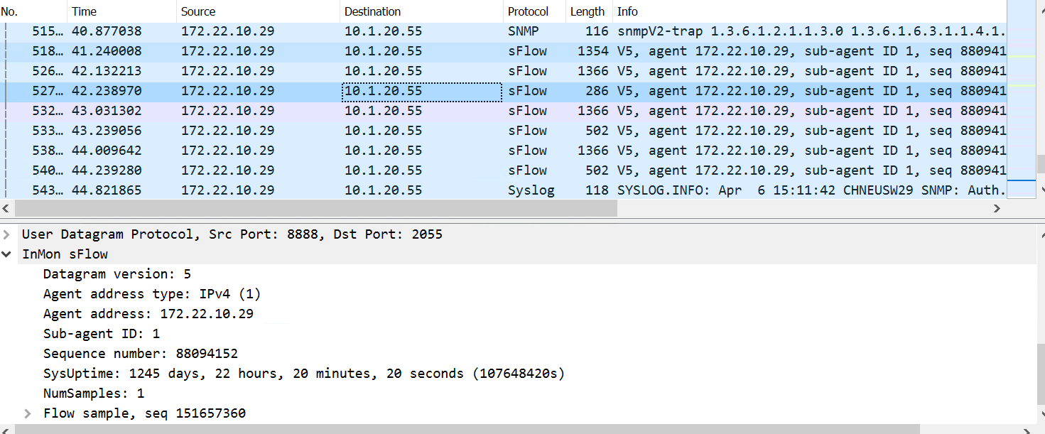

Indeed, netflow is configured on the brocade switch. Also, I can see packets on the wireshark using sflow analyze.

sFlow version: 5sFlow services are enabled.sFlow agent IP address: 172.22.10.291 collector destinations configured:Collector IP 10.1.20.55, UDP 2055Polling interval is 30 seconds.Configured default sampling rate: 1 per 512 packets.Actual default sampling rate: 1 per 512 packets.The maximum sFlow sample size: 128.sFlow exporting cpu-traffic is disabled.90685262 UDP packets exported151675784 sFlow samples collected.sFlow ports: ethe 0/1/5Port Sampling Rates-------------------Port=0/1/5, configured rate=512, actual rate=512
