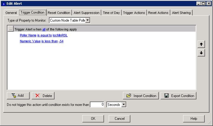

(I am having trouble setting up an alert based on the Received Signal Level (RSL) of an Exalt wireless radio from a Universal Device Poller.
I chose 'Custom Node Table Poller'
Trigger Alert when 'all' of the following apply
Poller Name 'is equal to' locMinRSL
Numeric Value 'is less than' -54

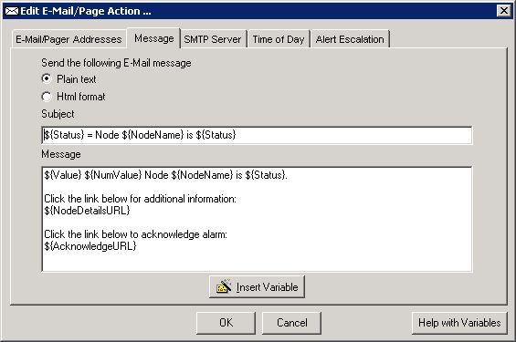

I can't seem to get the correct value to report on the 'Triggered Actions' alert message. In fact I don't even know if I have the alert setup corretly. I tried variables ${Value} ${NumValue} and everything seems to report 0 (zero).
Can anyone guide on what I am doing wrong and how to get the Trigger Action email to display the actual value? If the value of the RSL falls to -55 or lower on the wireless we want to get an alert. Here's a couple of screenshots to help. The Message doesn't makes sense I am just trying to get the correct string to display the value which is usually around -45.
