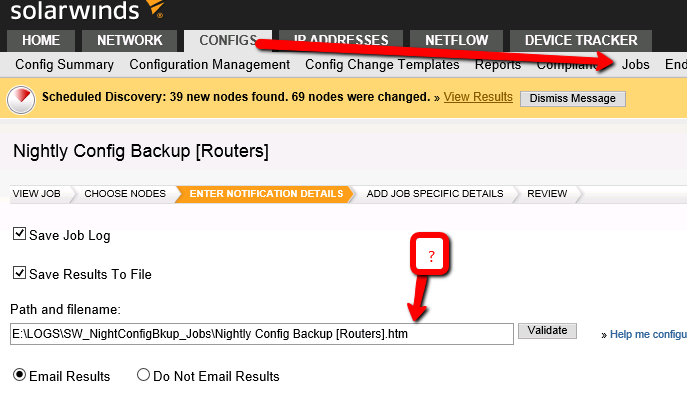

Anyone know how to configure the saved job result to NOT overwrite the previously saved job result file??? Looking to schedule this and not have to manually edit the NCM job every day to manually change the saved job log file name.
NCM 7.3
Thank ya!

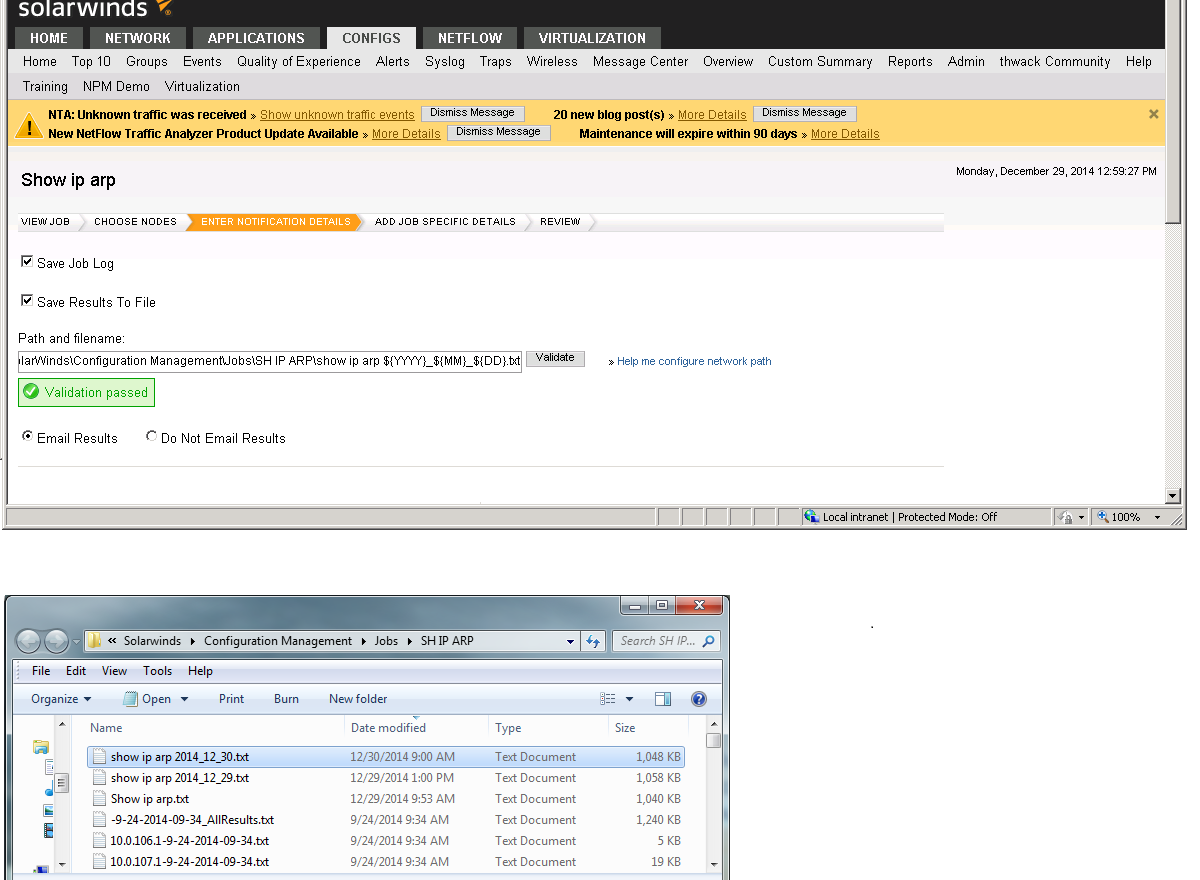

ohionetadmin,
I had the same issue, each night my job file overwrites the previous file because it was the same name. Tim's suggestion worked for me, use variables with date (and time) in the filename.
Filename:
C:\...show ip arp ${YYYY}_${MM}_${DD}.txt
9/24/2014 was when I upgraded to NCM 7.3.2 from NCM 7.1.1 and "Show ip arp.txt" was being overwritten each day.
Now with the date variable, it will give me a new date/file each day.
http://www.solarwinds.com/cirrusdocs/wwhelp/wwhimpl/js/html/wwhelp.htm?context=CirrusDocs&file=CirrusAGVariables.htm
Search for variables and others will show up as well. I can't find the complete list, but here are some.
