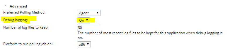

Now the issue I'm having is when running the powershell script the Invoke-WebRequest times out. I can set it to 1 sec and the script fails after 1 sec, 30 sec it fails after 30 sec, etc. so this tells me the script is trying to run but isn't completely working for some reason. I ran wireshark on the server I'm testing the script on but I don't see it even trying to open a connection. Is there some kind of environment setting that would be prohibiting the script from opening a network connection? Or some other caveat I'm not aware of?
