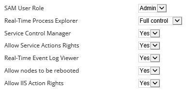

Hi all, on version 6.4 SAM Orion and trying to get the Real Time Process explorer working for Linux.
It works for Windows ok, but any Linux this option is missing.
My account permissions are setup as below on the SAM account, so looks ok.
Any ideas?

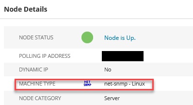

The only difference I'm seeing differences is the machine type - working is labelled net-snmp Linux. Not working is machine type Linux.

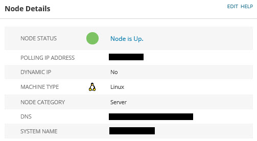

How is the node identified in Orion? E.G. What's the vendor type? A screenshot of the 'Node Details' resource for the node where this option isn't available would be very helpful.
Here is the Node information, both are polling via SNMP with the name community string.
Real Time explorer working - Machine type - net-snmp-Linux
This is on the box which is not working with RTE - Machine Type - Linux
Out of curiosity, How is the machine type being populated as 'Linux'? Do you have an Agent deployed on that machine?
Hi - no agents are installed, these Linux servers are setup with SNMP.
Hi Alterego
I think those devices are identified as Linux because there is a node details poller assigned to it.
