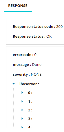

This is how you make sure it works, at a basic level. When it works, you get this when you send a query. Which should be loaded differently, but each number there starting from zero is incrementing and listing each of the load balancer groups you have.

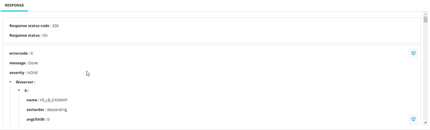

So, here's the metric in question from one of my netscalers. I monitor the VSLB health, which tells you when something has dropped (percentage value).
When this is done, you can then poll the Netscaler and pick what metric you want when you click on the little monitor icon on the right side next to the metric you want to obtain! Happy monitoring!

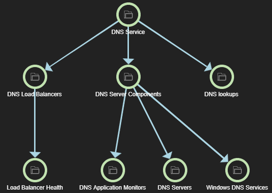

As a result, you can put the load balancers in a group and the API pollers into a child like this:
