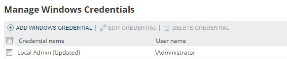

As an FYI - I just invoked this verb and the name did update (so I'm assuming the username and password did as well).
