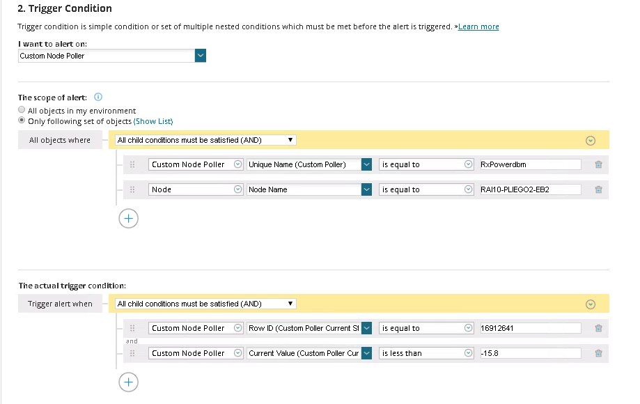

Hi, every one, I need some help creating and alert.
I have a uDP that give me the attenuation value of the all optical interfaces in a device.
This devices can have 2,4, 8 optical interfaces, depends on the device.
Every interface can be different and need to be between a certain range of attenuation.
Interface 0/0/1 can be between -10 and 4 and interface 0/0/2 can be between -17 and 2.
So I need an alert for the interface 0/0/1 when the attenuation > 4 and <-10 an alert for the interface 0/0/2 when the attenuation >2 and <-17.
This is what I configured. I am using the row ID to identify the interface because the uDP is not giving the name interface.
I tested with Current Numeric Value and the Current Value.
At the moment is not working, so I need some tips to achieve this alert works.
Maybe the problem is because the uDP is a table and I can´t get the value for a specific interface?

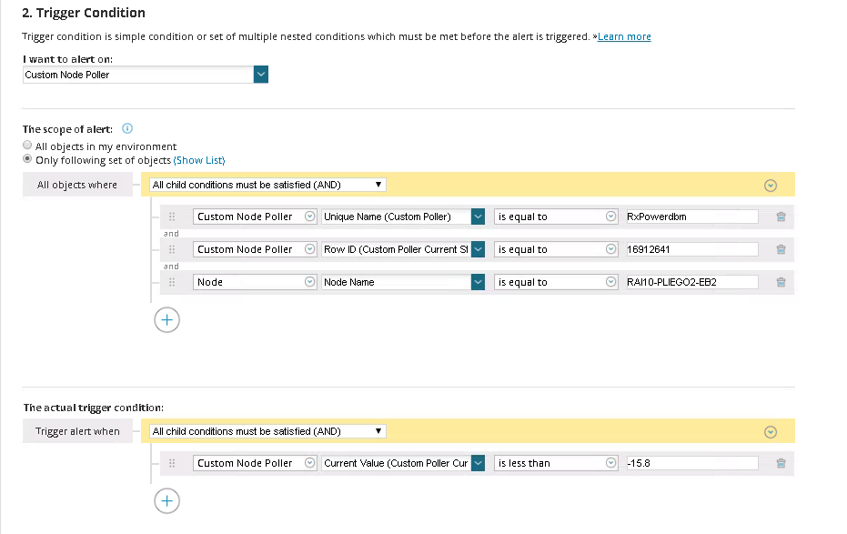

I tried this option too.
