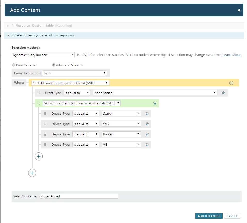

I was able to create a report on specific devices added within the last 7 days which is perfect. Is there a way to add who added this device?
In the "Select Method" drop down select Advanced Database Query (SLQ,SWQL) instead of Dynamic Query Builder.
USE THIS
NOT THIS

How would be able to create this on the gui?
I used this to create my original report
This works, but does not give me the any of the information from the report I created. I just need to add who added the device added onto my current report
