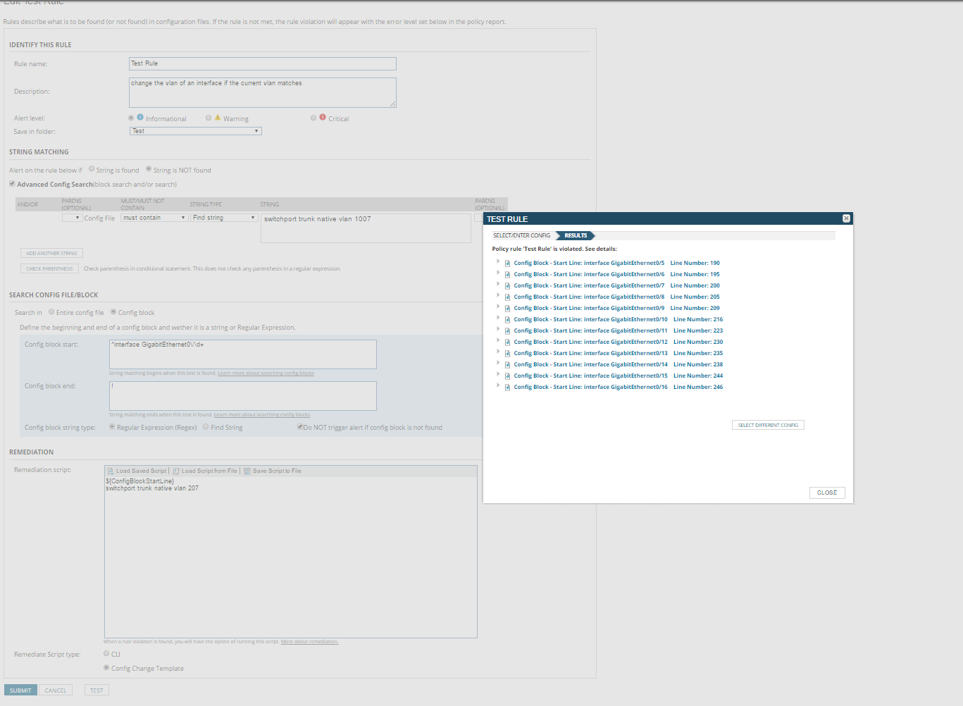

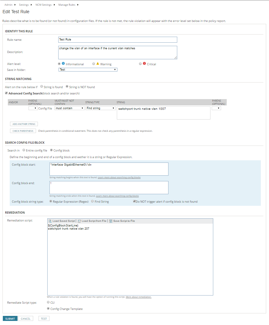

1. Made a rule based off of the previous article
2. Tested Int 0/1 - /04 are no listed, but they are the ones that should match, the ones listed say "no matches"

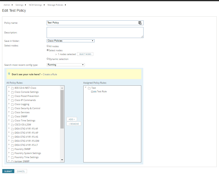

3. Make a Policy. Added the Rule and set the Node to only my test switch.

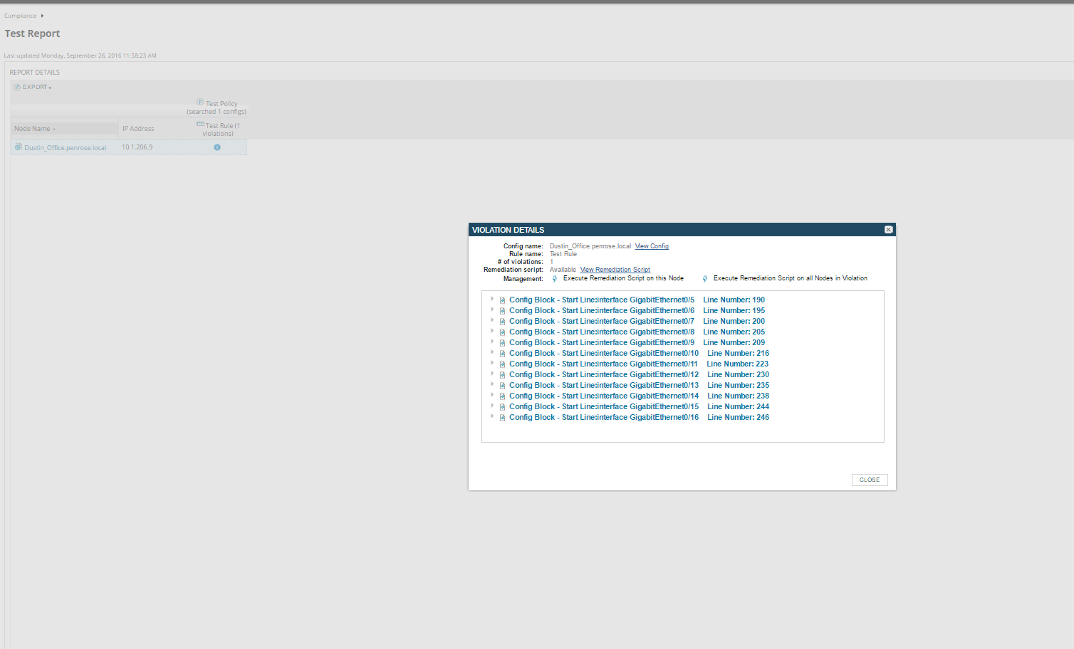

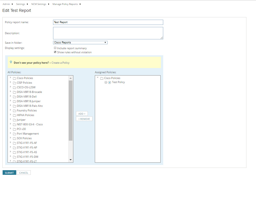

4. Create a Report. My test policy is applied
5. Run Policy and get results.

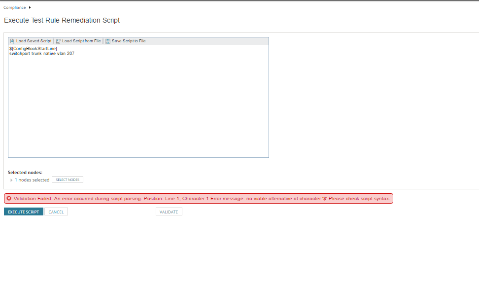

6. Execute Remediation. Here is where the failure happens
I get that it doesnt like the ${ConfigBlockStartLine}, but what else can I do to only change the specific interfaces that are triggered? Any help is much appreciated.
