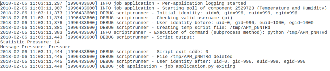

When I look at the debug log for the application on the agent, I see this:
Which leaves me confused.
I understand the err on the application page, because the outputs(Static.Pressure and Message.Pressure) are not defined.
But I can't define the output within the template if the output is not returned.
The script seems as though it is being interpreted absolutely perfectly because in the debug file, the output is shown as expected, without error.
I just can't figure out why that output isn't *seeming to be brought back when editing the template.
