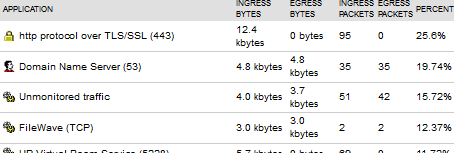

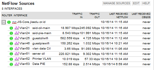

all is ok with NetFlow analyzer on 10.1.3.25 but not on solarwinds NTA..
collector services is UP and running and netflow sources already giving amount of data throughput
but on the top protocol, endpoint and another details just showing me the traffic only on small bandwidth... this is not right...
it has to be in megabytes and gigabytes... that is displayed with another Netflow analyzer...
what is wrong.. is there any configuration that I missed...
