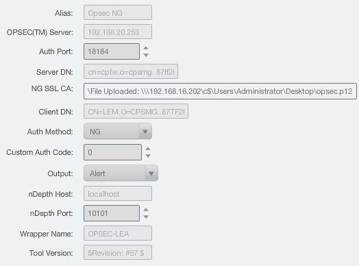

I created OPSEC connector

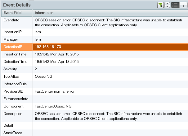

When I started it, internal warning appears immediately and no event is collected.
Can you give me a hand?

So, it appears that you have the Opsec Application setup correctly based on the screenshots. Did you set the one-time password in the Communication screen under the Opsec Application? What is the Trust State when you initialize the application?

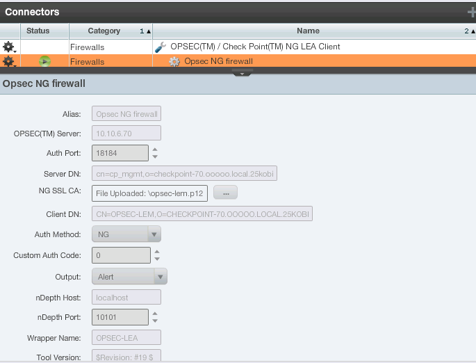

Environment have two production devices. for management and gateway.
The OPSEC build on management server.
And, I done successful open Checkpoint NG LEA connector.

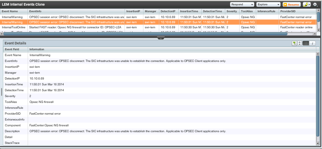

but I got same error message
