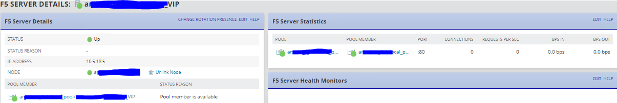

This is made easier by a new feature(?) for 2020.2 on the F5 Server Details page - Linked Node
Setup
For now, you need to setup a linked node manually for each Virtual Server record. If using a HA pair of F5s, be sure and set the link up on both nodes.
Manual Method
- Browse to each F5 Server screen, click Link Node.
- Select External for the node type (and whatever custom settings make sense)
- Save node.
When finished it should look similar to this (the status icon next to Node will start off purple - before the alerts change its status):
