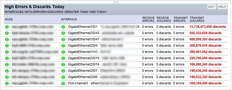

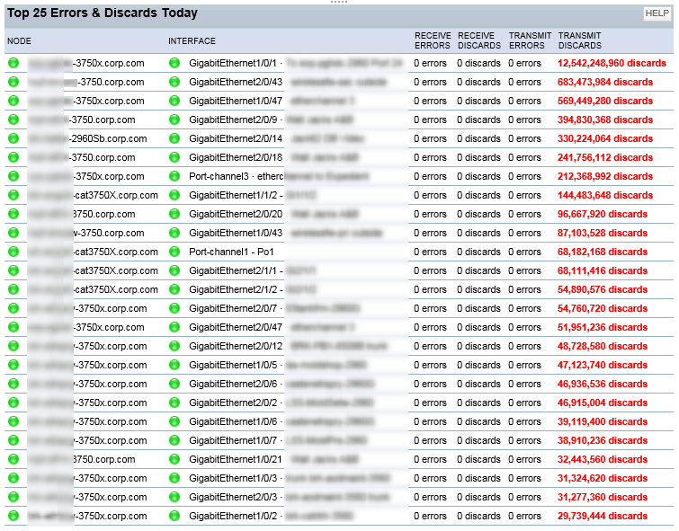

High volume of transmit discards being report to orion. This information does not match what is found on the switch.
No idea why such an alarming rate is being recorded.
Is there any valid explanation why this is being reported?
