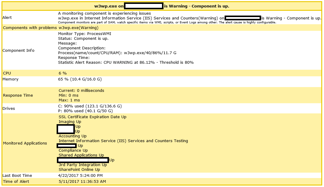

Like I said, I try to include everything, so here's an example from the Component Warning alert, with private stuff blocked out
Top section has the AlertMessage in the header (the Message displayed when this alert is triggered thing). the Alert section has the AlertinMessage Custom property. For some reason you can't use the same variable in the AlertMessage and AlertingMessage or you'll get a circular refrence error (so, that seems to be a bug in Orion). I included all likely Component info, so the Event Log info is in there if it's an event log alert, response time if it's an HTML test, and so on. As expected, CPU and memory, response time. I've included info on all drives, and on all monitored applications, with a last boot time and a time of alert at the bottom.

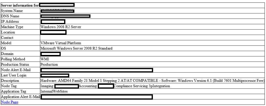

Server information section has all your normal info about the server that shouldn't really be involved in an alert.

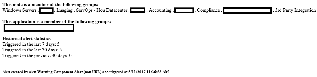

Last section is other info: Node group membership, Application Group membership, alert frequency, and then when it alerted.
