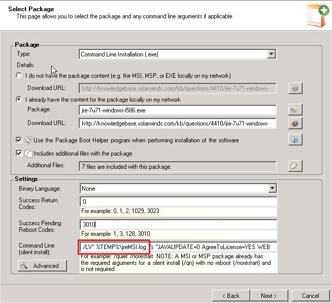

We have a need to enable the java verbose logging.
We have tried using the parameters that Oracle documents ( /LV* %TEMP%\jreMSI.log) to do this via the "Command Line (silent install):" field (screenshot below) on the package but the update fails to install. Note that there is no jreMSI.log created.
The question I have is; does the command line honor the windows variable? Or do we need to set that as a static path (i.e. C:\windows\temp\jreMSI.log)?
FWIW, running these via command line locally on the system works fine:
jre-7u71-windows-i586.exe /LV* %TEMP%\jreMSI.log /s "JAVAUPDATE=0 AgreeToLicense=YES WEB_JAVA_SECURITY_LEVEL=M"
jre-7u71-windows-x64.exe /LV* %TEMP%\jreMSI.log /s "JAVAUPDATE=0 AgreeToLicense=YES WEB_JAVA_SECURITY_LEVEL=M"
- It is only when the same command line is used within the Patch Manager patch does this fail.
Another note is that if we remove the " /LV* %TEMP%\jreMSI.log" parts and republish, it works fine.
