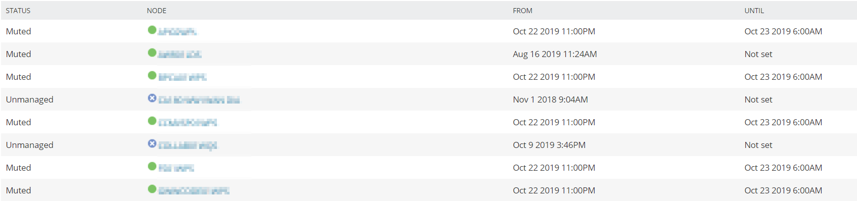

I'm expounding on an original request I made here.
I want to list the status, node name, from - until and who muted/unmanaged (not in screen shot).

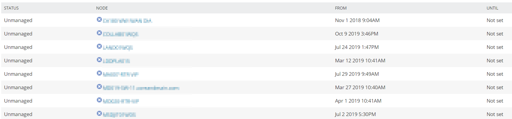

I've come dangerously close by using the query written by grta on this post. The problem I'm having is that the Muted nodes are still showing up in the query despite their "until" times expiring. I used the snipped of code that @grta mentioned in their original reply but when doing so I only get Unmanaged nodes. I do have muted nodes to test with, I set one indefinitely prior to running this query.
The code in question is, you'll see that I added it to the 2nd select.
where
-- Added to remove outdated period of muting
tolocal(SuppressUntil) > GETDATE()
AND tolocal(SuppressFrom) < GETDATE()
