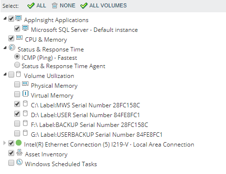

Question to all my fellow Solarwinds Admins. Is there a way to mass add select hard drives to the Node's monitored resources; like in the image below where i'm doing it for a signal node?

You can set up a discovery, check the box on the second screen where it asks if it should update agents. The only limitation right now is you'd have to add all fixed disks, discovery doesn't allow you to do things like "only add c or d drivers but ignore any others"
Thanks for the info, i had tried this but didn't check the agent updates box. After running this though I was only able to discover about 700 agents and get the drives added when we have almost 4000. I reran the discovery and it found maybe 100 more. Do you know why its not discovering the rest of my agents?
You're a genius, i keep missing the small stuff. Changed the poller and its identifying the others.
